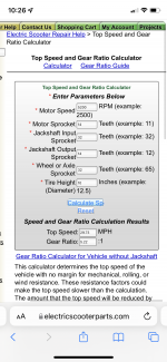

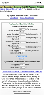

I plan to achieve this with a couple changes.
1. locking the motor controller in the slow setting. The current top speed in the slow setting is 18mph, it’s 25 in the medium, and 30 in the fast.
2. this kart has a jack shaft, so I can change a couple gears to further reduce the speed. It currently has two 32 tooth and two 14 tooth gears… I can easily change the 14 teeth gears out for 11,12, or 13 teeth gears which should produce the desired result.
so, by fiddling with the gearing and the the controller speed settings, I should be able to get it into the “safe” range.
Here are couple gear/speed calculations. By changing the 14 tooth gears to 12, I get almost a 30% reduction in speed. And this doesn’t account for putting the controller in the slow setting. I would expect it to now be firmly in the teens speed wise with more torque.
if that doesn’t work, or it’s still not safe, I’ll just mothball it until I find a different frame.
