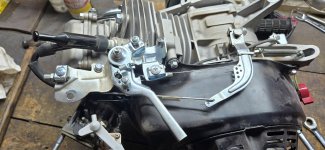

I have a brand new 2008 Greyhound 6.5hp engine I just put on a go-kart for my grandkids. I took off the govenor linkage, then changed my mind, afraid the grandkids might launch into a tree. I put the linkage back on, triple checked the linkage, adjusted the govenor. Here is the problem, with the engine off the carb butterfly will not automatically return to idle position. When started it's full throttle. I'm not sure about the govenor shaft coming out of the engine, it moves freely when not running, moves about a 1/4 turn, should it have some drag? I'm not understanding why the butterfly won't close, I can push it shut with my finger. when I move the throttle the butterfly does not change position.

Believe it or not, with the engine at rest, the carburetor butterfly is wide open. When the engine starts, the flyweights in the governor swing out immediately (or even when you’re pulling the recoil), the center button goes up and presses against the paddle arm and it slams the butterfly closed (via the linkages), to idle *or wherever the throttle is set.
Supposed to be that way. Guess it’s one of those quirks.
—> However, it is not supposed to stay at full throttle. Something is wrong. Please post some photos so our team of experts can diagnose your engine. Some here can do it blindfolded.

Wow, thanks a lot. Clearly stuff I did not know, and thanks for the pic. I'll give another run at it tomorrow. The setup in the pic is how I had it hooked up, so I must have another problem, as suggested. If I can't make it work I'll post some pics. FYI, videos that I watched online show the butterfly closing, go figure? I'm sure you are right regarding the learning curve.

Using WTR’s pic, the curved arm on top furtherst to the right, connects to a vertical rod that goes into the engine crankcase. If you took that all apart, the relationship of the vertical rod and the curved arm may no longer be “clocked“ properly to work. Correct me if I am wrong fellas, but you should loosen the horizontal “pinch screw” on the arm and then put a wrench on the vertical hex-head bolt and turn it clockwise until you feel resistance. Hold it there and tighten the pinch screw. You may need three hands, not sure.
Then connect the linkages, et voila.

Hope the pics made it to the forum. I think the go-karts are "Invader" brand from the 70s or 80s. I took everything off and put it back together, see pics. No change WOT when engine starts. I can slow it down manually, but thats the only way. I'm starting to believe the govenor has come apart inside. I have done a little nuckle dragging over the years, it does not feel like brain surgery, 2 springs and a rod. Cannot see anything getting in the way of the linkage.
