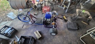

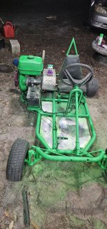

My story is fairly new I mean I rode go kart alot as a kid but atvs took their place. Within the last year I've gotten back into Karting. I was messing around on YouTube and seen some drift trike videos and decided to build one. My boss had an old go kart that hadn't been run in years and ask me if I wanted it. Of course I did it had a honda gx340 and would make a good start to the trike I wanted to build. Bought me a live axle kit and built me a trike. Had alot of fun with it but living in the country I found out it wasn't practical. So I took the motor and axle off of it and what was left of the 2 seater go kart that I cut up to make the trike and made me a one seater go kart.
Now it's an addiction. Not sure where it'll end ive removed the gov, jetted the carb, new high flo air filter, billet rod and fly wheel, heavier valve springs and built the exhaust pipe. Just got the motor back together a few days ago. This thing is wicked fast with the 40 series torque a verter. Now to change weights and springs and dial it in. Sorry about this novel I just wrote I get excited lol.

I haven't went that far yet. As far as milling the head but it's within the for seeable future. This 340 is almost 20 years old it's survived my boss man's 3 youngens. Which are all grown now. The cart was a big 2 seater with a roll cage and 1in solid axle. I seen it everyday for about 3 to 4 years rusting away. I rescued it well I cut it up and made a drift trike out of it then when all the fun was had with that I took what was left of the frame and roll cage and built a single seater. The joker is what I call it cause I painted it florescent green and purple. But all I did was clean the carb when I got it home and got the trike ready. It fired up on the 1st pull. It's surprised me with all the hell those boys put it thru. The only reason I rebuilt it is cause to much is never enough. And know that I know how easy and cheap they are to put together it's all over but the crying. .. lol20241101_213227.jpg
