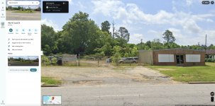

Seems like Robron is defunct but the sign is still up [click to embiggen] and someone cuts the grass...
If you pan left on street view, looks like there’s a sick ’49 Merc in the weeds.
