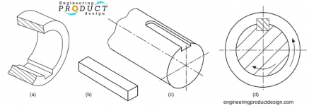

like a piece of metal that keep the wheels spinning along with the axle. it goes in a slot on the axle and another slot in the wheel.1610216646573.png
