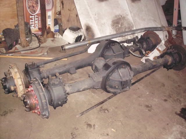

-the axles are going to be narrowed down ford 1/2 tons from a 79 ford ( d44 and 9") both welded diffs

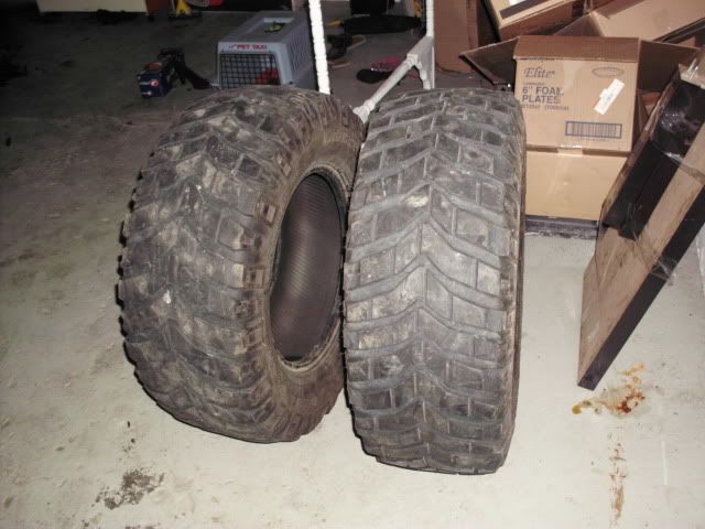

-tires for now are grooved out 33" baja claws but i think im going to get some 8x16 v-treads later on

tires before grooving

Been looking for a narrowed 9" for my nova? You do this work yourself? What are the axle's in the pics?

still using the original go kart frame , might have to stretch it a foot or so but undecided yet. yea im doin all the work myself. the axles in the pic are whats going under it , theyre 79 half ton ford axles rear is a 9" 31 spline ford , front is a hp dana 44

Are you sure you couldn't find a bigger diff???
haha well i do have a set of these layin around my shop that are goin in my mudtruck
those are 2.5 ton both steering eatons. next to the axles im puttin in the cart they make them look like go cart axles :roflol:

I do not think those are 9" ford axles. Maybe just a mock up?
yea thats the ford 9" for the rear and the d44 is the front , those are the exact axles being used for this cart , the rear just hasn't been narrowed yet in the pic your seeing
