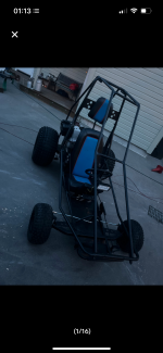

Ho all, I bought my son a secret gift that I wanna shine opp and get it fixed so I was hoping for som expert helt from you all.
I have bought a Manco 390U with trailer hitch. Engine is beloved to be original tecum 10-13hp electric start.
The previous owner disassembled the carburetor on it and lost it and bought not original and lost all oft the spring setup on it also.
Engine starts but won’t run well so I was thinking maybe to get thing fixed quick is to buy new engine and pulleys and all the other stuff I need. Frame will be dryice blasted and primed and epoxy painted in his favorite color Cortez silver with black details.
any her who can help me with recommend parts and stuff to it so that I can get this ripping till his birthday?

When is his birthday? If it is tomorrow (or in a week), a lack of planning on your part does not make it my emergency... 😄
What is your level of mechanical ability? Are you a total novice?
If it were me, I'd just get the engine running and clean up the kart really well, wash it and maybe even wax/polish the original paint. Save the "custom paint" for a later time and then you can take your time and make it a father and son project.

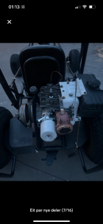

Looks like the carburetor may be all there but the pull start needs to be serviced so the rope isn't hanging out like that. Having an operating pull-start is important I think as it teaches you and your son to master manual starting.

Spring is fixed but carburetor is not good. Low compression also so considering new engine but unsure what to choose that is durable and of course enough power for him to have fun with. And yes not many in Norway so hope to find more of them later because I have 6 kids 😅

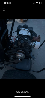

Have tested compression on it and it’s low, afraid sylinder rings are bad. That’s the main reason I was thinking to replace it and rebuild the old engine later.

Since it is a flathead engine, it might need the valve clearances adjusted to restore compression.

Starting disassembly tomorrow so will find out then 🙂 much appreciated all advice and tips one can get 🙂
