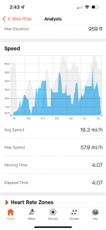

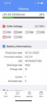

She’s a runner. Competed the battery and figured out mounting. 32AH of the lipos was just the right amount. I can run hard for 15 minutes and the packs are barely warm while the controller is slightly hot and the motor is about as hot as it should be. Can place my hand on it but it’s at the limit of not being painful.
After those 15 minutes the cells are all sitting around 3.8v which is perfect. I’ll still put them on the charger for a 3.85c storage charge though.
I also installed 4 Batt Airs which Bluetooth cell status to my phone. Makes it super simple to check.
This was my 2nd run with the new packs. First run the 4 gauge phase wires were kinda hot so I replaced them with some left over 0 gauge from my car audio days.
Used Strava on Apple Watch to track the ride. Said top speed was 57 mph but I don’t trust that. I bet it’s around 50.
