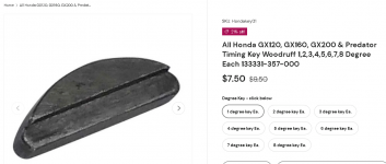

Looking at the timing advance Woodruff keys for these engines and wondering how much I can advance the timing and be reliable on 91octane?
Engines are governed to a max of around 4000rpm, peak torque is around 3600rpm, engines are designed for efficiency and power at 3600.
