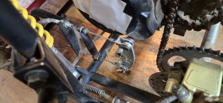

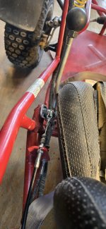

I have been building a custom card. It was a random idea. A friend had given me a 200cc tao tao engine, But the manual shift does not work with the design. I need some insight for alternative shifting options. Please and thank you.

Let’s see some pictures of the engine and what you’re working with. Lots of people have built manual shift karts so, it does work.

Thanks, anything helps. Handle shift won't work because I did a semi independent suspension.
