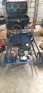

D donnieboy New member Messages 4 Reaction score 1 Jun 20, 2023 #4 What kind tc do I need Attachments 20230620_161901.jpg 1.2 MB · Views: 7
R redflash Well-known member Messages 650 Reaction score 625 Jun 20, 2023 #5 if you have 3-4 hp.....get a series 20........if you have 5-9 hp get a series 30......over that a series 40.......when you get over 25 or so hp you need a whole different animal. Da redflash Last edited: Jun 20, 2023

G.W Well-known member Messages 764 Reaction score 499 Location Nyssa Oregon Jun 21, 2023 #7 Get a 30 series if that's a 212. Welcome and.i hope you enjoy the hobby
