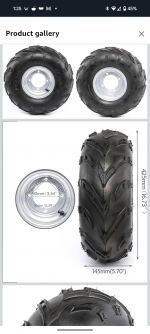

Alright, I found some wheels that should match up to the bolt pattern on the hub, but my concern here is the center opening. The center of the hub is only 32mm and the center opening of the wheel is 90mm. That's going to leave a good size gap.
Think it'll cause issues?

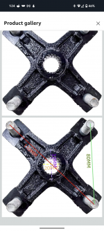

I've spent more time than I'll admit comparing the bolt distances on the hub. One of them is wrong.
If the bolt distance is truly 80MM, then the distance across is 113.14MM.
If the distance across is truly 110MM, then the distance from bolt to bolt is 77.82MM.
Somewhere along the way they've rounded a number but I think it's close enough that it'll work.
