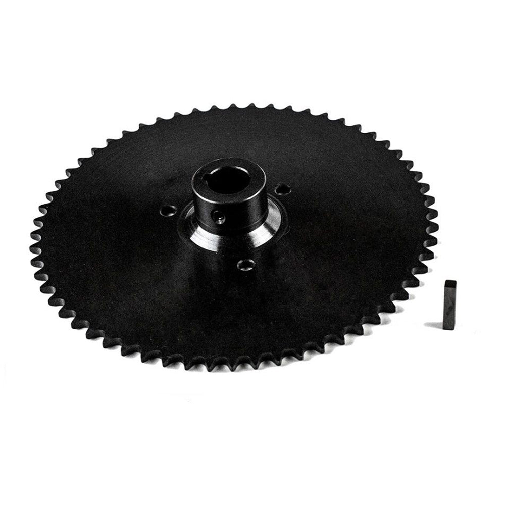

Yup! Yes! Si! Wi wi! Da! Just add a Genuine Comet belt to the mix and your good to go! One other thing I want to add is to use a 6:1 gear ratio. That is with #40 chain size. That means using a 10 tooth sprocket from the driven and a 60 tooth axle sprocket.
