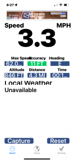

A little update on the 670 build. I have changed so much. Gearing, drivers, weights and rollers in the driver. Driven, and custom spring. Different length belts. Changed the jackshaft, and pillow block location. Better chain etc. custom build figure twice the budget and 3 times the amount of hours to complete. lol. Not burning belts anymore, but they are stretching. Comet belt stretches the worse. Comet was sold and belts aren’t being made in the USA anymore. According to a comet engineer. They have been very helpful with this build. G- force belt is a little shorter and changes the low gear and top end gearing. I have to change gear ratio to compensate. Top end numbers are only a few tenths different. I added the 506 cam, stiffer springs and the shorter HD pushrods. The most I have turned the motor is 4550. That was with the 6.33 gearing and the short belt. That was 60.0 mph. The bigger comet belt with 6.0 gearing was 4350 62.0mph. The short belt 5.0 gearing was 3850 at 61.8 mph. Changed the exhaust around. I was thinking the belt may have been too close to it at top end. Pic of the new exhaust. No muffler. You can see the plugs, the carb is dialed in. That is after a top end run. They get a little light brown trail riding, and keeping it under 50. I bought a reverse gear box for it, but I’m indecided if I’m going to use it. Not sure it will handle the hp and torque now. Proly 33hp and 45lbs of torque with the mods. By the way Cam sounds awesome. Now compression release idles at 950 now.
