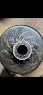

Hi all- I’m back hoping to get some more help with the go kart rebuild. As mentioned in my prior post- my neighbor recently gave my kids two go-karts. One is a rattler II and the other is a rattler LXT. Both were sitting outside for a couple of years so a lot of tuneup and replacement of rusted parts. I swapped out the clutch on both of them with centrifugal clutches and new chains. On both karts they seem to engage when you give the kart gas but then lose power and doesn’t seem like the clutch is engaged or strong enough to move around. Because it happening to both, I feel like I’m doing something wrong. In hindsight- I wish I had gone with a torque converter instead and might still go that route but want to make sure I’m not wasting money if there’s a bigger issue. The clutch on one wasn’t cheap- I bought directly from comet and cost me 80-90 dollars…. My point is I didn’t buy a Chinese made POS on Amazon. Any ideas or suggestions would be appreciated. Thanks

What is the gear tooth count on both karts {clutch teeth and drive sprocket}?
What are the heights of the rear {driven} tires on both karts?
Count them, don't just guess or half-arse count the teeth and hope close enough will do. Mark the starting point with a Sharpie if you need to. We need accuracy.
Measure the height of the rear tires with a ruler/tape and at full inflation {even though the height is likely printed on the tire, don't trust it as it can be quite inaccurate}.
9,263
4,234
I am asking these things to determine your gear ratio.
If the gear ratio is abysmal and not ideal, you could be having issues with drivability and clutch roasting.

Apologies if I blew up the forum with multiple posts… the site was telling me that it had a technical error and to try back later… I had no idea they posted… that said
Neither had belts they are both chains. I matched the clutch and teeth count to the ones that were on them.
the LXT has 18 inch rear tires with a 11 tooth clutch
The R-2 has 12 inch rear tires with a 12 tooth clutch.
We need the tooth count on the axle sprockets too, that's the bigger one. Large sprocket divided by small sprocket gets you the gear ratio.
Kart 1 - 11 tooth clutch, XX tooth axle sprocket
Kart 2 - 12 tooth clutch, XX tooth axle sprocket
Happens to all of us. We just ignore the error message, hit the X on it refresh and voila, the message posted. Yeah I know, it blows.
Kart 1 - 11 tooth clutch 54 tooth axle
Kart 2- 12 tooth clutch 80 tooth axle sprocket

ShermDog, with 18" tall rear tires it will NEVER work with a centrifugal clutch. Well maybe a 10 tooth driving a 140 tooth. You need 30 series torque converters. Plain and simple. No two ways about it. The $60 cheapies on Amazon are as good as any. Do you know what size chains are on the karts. They will come with a 10 for a #420 chain and a 12 for a #35 chain. 10 X 60 is ideal. 10 X 54 will still work. You may have to change the 80. Try it. It will be pretty low geard. A stump puller. Depends upon terrain and driver preference.
9,263
4,234
12 tooth kart with 12” tires should be fine with that gear ratio 6.6:1, but clutches also just love full engagement. The engagement RPM can be regulated and adjusted with shoes and springs. The article I linked is top notch in how you’re supposed to drive a centrifugal clutch. Clutches are better for racing….
With a torque converter, it just provides a variable gear ratio and they are better for lots of stop and go driving and low torque applications like trying to drive up a hill in low gear. They’re really quite amazing for what they are…
Pay attention to Pancho’s questions in particular.
