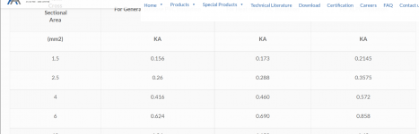

The 1 second rating of 6mm2 cable seems to be 640A and this fuse is supposed to open in less than a second at 180A, so it looks safe?

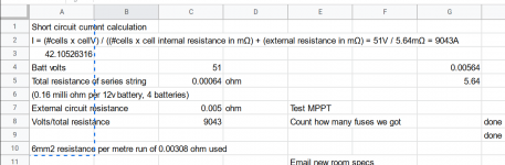

When my 48V pack is fully charged it is at 51V or so, a bit over the max for this type of switch. My very rough calcs based on the battery datasheet says the battery could supply 9000A of short circuit current. 2xIxt = 2x9000x1=18000joules, this fuse melts at 1400 joules to open the circuit. Sorry was a bit late at night when I did that math so it probably is wrong. The breaker you linked is rated at 3000A, which I think means the guts of it would melt and provide a closed circuit instead of interrupting the current.
I think that breaker you're using would be perfect for tripping if there is a short inside a an appliance on a boat for eg, but a direct short across the chassis of the kart or battery + cable to battery - cable would not be interrupted.
