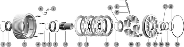

It's possible to put a clutch on the axle, although probably not a $15 centrifugal. Axle clutches used to be available for racing karts, but they're big money when you can find them. Years ago I bought a sprint kart roller that had one and sold the clutch for what the kart cost me.

The one I had was a gold SMC axle clutch. They made two different versions; a narrower gold one for shorter races and a wider red one for endurance racing. They're both physically pretty large.
Burco and Horstman also made axle clutches.
