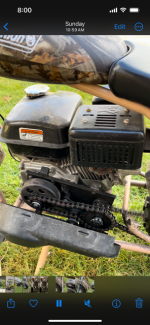

I bought a Coleman CT200U-EX a couple weeks ago. It started right up and idled nicely in the seller's driveway. I got it home, and now it idles with a vibration that is going to shake all the bolts loose. The vibration goes away when you give it some gas, but you can't sit on it while it idles. I could use it to shake paint cans, but I don't want to sit on the thing. I can't figure out how to attach a video. It would be helpful if I could figure that out...
Any idea where I should start looking for the problem?
I couldn't open it up at the seller's house, but once I got home I ran the bike as hard as it would go. What a disappointment. It might go 15 mph if I'm lucky, and it has no take off power whatsoever. I weigh 180 lb, so I thought it would do a little better. It's completely stock right now. Is this typical performance, or is something funky going on? Is there a cheap way to make it more fun? If not, I think I'll sell it, if I can make it run smoothly, and I'll look for something with some gusto.

You'll have to post the video on a file sharing site (YouTube for example) and link the video here. My 1st question would be: Are there any bolts loose, specifically the ones that hold the engine to the frame?

Post a picture of the bike, especially the drive side. Even in stock form it should be capable of 25 mph. I have a Trail master 200, about the same size and weight as yours. With a built 196cc and geared low (strong acceleration) it tops out at

Denny, it has a centrifugal clutch with the gear-reducing jackshaft setup.
I attached a screen capture from the vibration video I took which shows some of the drivetrain. It's a stock setup. If I could get 25 mph I would be thrilled. I wish I had a "healthy" bike like it nearby to compare. I don't think my expectations are too high. The bike takes a while to get going. You want to encourage it along by pushing it like a scooter, and it tops out just about as fast as my eight-year-old kid rides her bicycle. Then when you stop it shakes your teeth out. It's not ideal!engine.png

Take the chain off the clutch and run the engine. Is the vibs from the engine itself or from the drive train.
I'm not sure if there's a counter balance wheel in that engine but it could have been re assembled wrong.

I'll be traveling for Thanksgiving, but I'll try these things when I get back. Thanks guys

Here is an interesting twist to the story. I figured I'd post it just to close the loop on this thread.
I texted the seller and asked if he did any work on the engine. When I told him what was happening he insisted that I take all but $100 of my money back and keep the bike. That gives me more than enough to buy a Predator engine and a clutch for a 3/4" shaft.
So, there's no need to figure out the vibration and lack of power. Thanks for everyone's thoughts.
