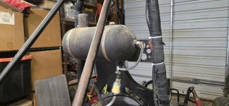

Maybe drill a hole in the top and bottom, install a sight glass. Clear vinyl tubing is cheap and easy to install. Two hose barbs, a dab of sealer and 6 or 8 inches of 5/16 tube.
Get a fuel petcock from a moped or small motorcycle with a "reserve" lever. When it runs dry from the main supply, twist the lever and restart, go home.
Add a small reserve tank and a cutoff valve. When it runs dry, open the cutoff valve from the reserve tank and have that gas run into the main tank.
5,021
4,403
Like this.
