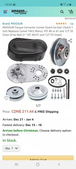

I'm building a kart from scratch (cannibal kart in more builds). I've been trying to work out the best drive setup. I've got an 8hp honda engine (3600 rpm max), 11" tall rear tires and solid rear axle.
I'm looking at the 30 series torque converter from Moosun, as it comes with 1" primary drive, and 10T #40 final drive sprocket. I'm not sure what reduction the torque converter has..
I'm hoping to keep the top speed quite low as this is for my young kids. ~20 mph top speed.
1) what size axle sprocket would you recommend with this setup? 42T? Or roughly in that range.
2) is there any real difference in quality between moosun and brave? Or other budget brands?
3) is it possible to govern top speed with a torque converter installed? As long as you keep above the engagement rpm?
4) last one. How difficult is it to install a torque converter? Is a separate mount required to support he jackshaft?

1. I would not get a 42T sprocket. That would give you a very high gear ratio of 4.2:1, which means that you will have a high top speed but will take a while getting there. If you want to go about 20mph, I would rather get a 60/72T sprocket to slow you down some. You will have more torque though.
2. All those clone TC's are about the same. We haven't ever seen any real issues with them. Just make sure you get a genuine Comet belt though, the ones that come with these kits last 2 seconds
3. Govern using gearing. It is a much better way to do it
4. They are relatively easy to install. There are also several YouTube vids that would do just fine if you want to see how to install one.
