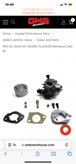

How big is the TCT carb? I thought I recently heard is was 12.5mm. I think a stock carb is 15mm. I’m not sure this is the route I would go, but not sure what I’d do to fix it.
Yup, you’re correct so the TCT is a no go. I guess I’ve either got to just go the VM22 route or set engine back up stock. I will update with what I figure out but in the mean time thank y’all! I’ve also been seeing a lot more oem flywheels coming apart lately so we’re not gonna be playing very hard until the billet flywheel/rods are put in the bikes.
1,859
They make some short adapters that can allow a gx390 carb on a clone engine. I think the gx390 carbs are closer to 22mm but could be wrong. A 390 carb on a clone isn’t great for stop and go. Hard to tune the “just off idle” (1/8 - 1/4 throttle) portion of the throttle range. I used a 390 carb once, now I only use slide style carbs. Ignore the methanol wording, photo just to show the carb and adapter.

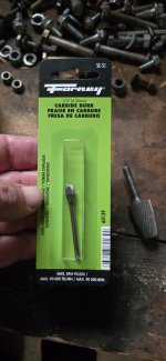

I find the drill flings the lapping compound. And yeah gotta be careful.
View attachment 151403View attachment 151404
Oops.
Drill works great for me. I’ve lapped many sbc heads the same way. Just put compound on the seat then a little on the valve edges and hold pressure on the valve. Wipe away and clean with brake cleaner. For me it wasn’t the carbide bit I had to keep from the valve seat but the part you tighten after the bit is installed! It’s easy to let that sucker hit.

Keep your bit oiled up, stops it clogging up with ali fillings, JB weld epoxy or aluminium solder/weld to address break through inlet side. I tig or Ali solder/weld if I break through the exhaust. Tried a few oils, ATF works quite well for me.
You can get a cheap £12 flexible extension for a dremel, works perfectly for a GX head, more control.
