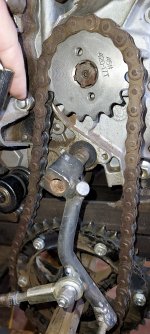

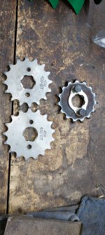

Got some go faster gears. Engine came with a 15 tooth. 40 on the axle is as small as I could get. 20240208_145100.jpgI got a 16 and a 17 tooth. Thought I'd have an issue with the 17 and clearing the case.20240208_144949.jpg
Moved the engine a little and reset the tensioner. Close but no rubbing.
With the 15 tooth I was always in 3rd and 4th.
The 16 brought it down a little but I felt it was always in-between gears.
Put the 17 on and now it acts like it should. 2nd and 3rd are mostly used. 4th is crazy fast and the sloppy front end doesn't want to hold the road. I got to about 45mph and I felt like it was gonna swap ends on me and I'd end up in a mesquite bush. (Thorns for you city folk).
