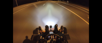

Today I finally got my Chevy Volt 3.1kWh (16s2p) battery installed and took my kart out for an hour long abuse test ride. My battery subframe contraption held up, though I am getting wheel hop instead of spinning when accelerating hard while cornering now. I ran the pack down from 65v to 58.26v over the hour, so it has more in it. My plan is to switch between my RELiON 51.2v 30Ah and this Volt pack, using the RELiON as a reserve; I am just waiting on my new 3 position switch to arrive. The RELiON is just running all accessories (lights, phone charging, horn).
I must say that this battery added noticeable power. It doesn't have the same sag under heavy load and isn't running out of voltage at high RPM, being stopped only by my 5500RPM setting in the controller. The extra weight makes cornering at higher speed without spinning out a given instead of something to be wary of, but it is some work to stay in the kart when going that hard.
Also, I made some mud flaps for the front wheels to keep little rocks and whatnot from hitting me and getting all over the kart. They work reasonably well, but hitting water at speed still gets some spray on me.
