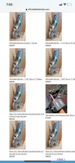

I was looking at placing a order for the tube bender by Affordable Bender. My question is, what is the difference between the bender that’s labeled “affordable bender” and “race car bender”?
by looking at the pics I can’t see a difference so maybe you guys can help me out

I'll venture a guess before I Google it................."Racecar bender" should be strong enough to bend very dense alloy large diameter tubes, well enough to pass strict pre-race pits safety inspections.

I’m uploading the pic. Notice at the top it’s the “affordable bender” and at the bottom it’s “race car” bender

Caveat Emptor, Will. Buyer Beware...........of misleading labeling and marketing materials. To begin with, all of those benders are sold under the brand name of Affordable Bender. Also, every one of those pictures is just a duplicate, they're all the exact same picture of the same bender, not even the dies are different. As to pricing, they're all priced basically the same for the basic bender, the difference is for the quantity of dies supplied with the bender. An extra die is $160 by itself, but you can get extras for less and less if your bender comes with 3 or more dies.
Apparently they're all the description of "racecar benders", it's just their marketing wording that calls some by the brand name and some by a description.
Ok awesome!! I just wanted to make sure I was getting what I paid for. I can’t really justify buying a jd square just yet
