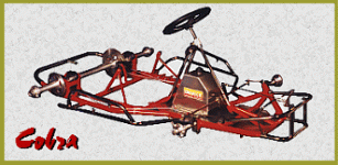

Really low resolution, but it shares considerable similarities with this picture of an Emmick Cobra! Look at the front end, triple bearing hangers, and the steering column where it mounts to the frame, looks pretty similar! But it does look considerably shorter than mine with a lot more steering column rake, looks like the Cobra was kid kart.
EDIT - Check this page maybe? http://www.vdm46.com/emmick-kart.html I combed through it but couldn't quite find a match. Looks kidna like a Venom or a Python. After looking at it, I'm thinking it's a late 90s/early 2000s kart, one of the later Emmicks for sure.
