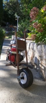

frame... didn't like first version ..
so changed a bit... and then , wheel was hitting a frame (03)...
so changed again .. still going to be tight ..

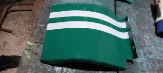

I do not like original fuel tank so maybe to use this one (at least to fill the gap between engine and seat)..
