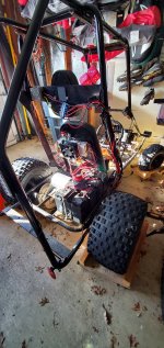

It's a Manco Dingo and it's a beast. Batteries are almost a year old (we started the project at the pandemic kick-off). We have all of the 12v accessories running through a voltage reducer. Here's a pic.

7:1 ratio on the 18" stock tires. Yes, FA...you were my inspiration on this build. We've gotten to about 30mph on a slight downhill (almost flat) grade. Can go about 22mph back up that grade. What motor/controller are you running on your manco? I just don't have the low-end torque I was hoping for. Maybe changing to 16" tires would help that. Are there stock 16" tires for the Manco? I will say this thing is so fun in the snow.

Wow, Kool!
...glad I could help
My ElDingo is long gone 😉
...that 8Kw motor, Kelly 72V 550A controller & a (48V) 2Kwh Chevy Volt module now power my ElMoto :cool:
(2) 2017 - El Moto | DIY Go Karts
Yup, smaller diameter tires or a higher gear ratio (or both) would definitely give you more low end torque
...but, at the expense of some top speed
...plus, your motor, controller & wires should run cooler too :)
Speakin' of wires
Um..."clean up on isle 4" :sneaky:
