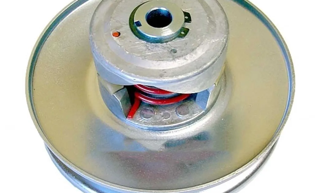

i would like to find a 9 tooth 3/4 bore sprocket to fit the jackshaft on a series 40 TC. After exhausting searches and phone calls, l have concluded that the above mentioned horn might be easier to find!
Does anyone know if such an animal exists and/or where one might be sourced? l’m ready to buy a 5/8/bore sprocket and bore it out to 3/4.

There is not enough room for the chain to fully engage the teeth on 3/4 bore 1/2in pitch sprocket.
That would be why it does not exist, I would look into jackshafts or a bigger axle sprocket.
