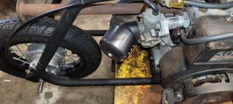

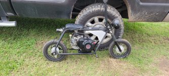

RCF standard frame and fuel tank. I have 10" dirt bike wheels with drum brakes. It is powered by a mild 5hp with a torque converter. I just put DOT street tires on it and I am in the middle of putting front suspension forks on it. I have a 20v to 12v adaptor for my Dewalt battery, head light, tail light, horn and switches. When it thaws out I hope to be able to have this street legal.

I wish! I ordered the wrong clamps. They are made for 1 1/8" bars so I had to buy shims for my 7/8 bars (blue tape holding them in place during mockup). The studs were not threaded all the way so to make them fit, I had to use spacers. The axles have the same problem also so I will run threads on everything and cut them shorter.

Do you have much experience riding with ape-hangers? Not the same on a motorcycle as on a minibike. Very unstable, be sure about it before building to or locking anything down until you know how it'll handle.
The bars are only 1" taller than the stock ones. The reason I want it street legal is to take it camping with me. A lot of rv parks only allow electric ot street legal scooters and bikes. I have seen a bunch of people go to the Honda Monkeys or a Ruckus. Being street legal, they can drive anywhere. I have a 45' toy hauler and I take my golf cart but I want to cruise my mini.

I should clarify about the ape-hangers..............While they can be fairly controllable short of getting the mini sideways, it's the apparent forward tilt of the mocked up bars that makes it look so dangerous to me. That same angle towards the rear would double the controllability.
