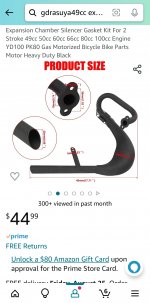

Hey yall, Im very new to this field and starting to work on my first project ever. I am taking an old Razor e175 scooter frame and attaching it to a Gdrasuya 49cc engine off Amazon. The rear wheel has 48 teeth and the engine has an 11-tooth sprocket. The rear wheel on the scooter is also pretty small at 5.7 inches. Is my gear ratio alright? Do I need an exhaust with this engine, and if I do yall have any suggestions from amazon? I apologize if these questions seem stupid, this is very new to me.

Yes you will need an exhaust. 2 strokes are a little tricky since an expansion chamber type pipe will make more power but they're more difficult to package. Most of the time using a 2 stroke with a good pipe you will end up building the frame around it. A scooter is probably easiest though. The engine will run just fine with a straight pipe and muffler though. If you are not capable of welding you should pick up an exhaust for that engine or whatever it's on originally so you don't end up screwed with however you mount the engine. The flexible one is interesting. I never saw that before. It may do you a big favor to have that option.

Thank you so much. what about my gear ratio?
Idk. Depends on if there is a gear reduction in the engines drive. 4.36-1 on that tiny tire is probably fine if it's direct drive. If it has a reduction box it's going to have a low top speed.
