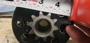

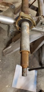

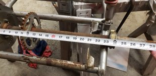

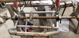

I’m in the process of bringing a go cart back to life for my granddaughter. It was junked and thrown behind my friends house. My best guess is that it’s made by Lance, imported as Coolster Challenger machines. I do a lot of favors for friends so quite a few have given me parts. I have a hardly used 212 Predator, and a brand new clutch that fits it. The chain for clutch is 41 or 420. The sprocket on axle is a 50.
Also when I was eyeballing in how the engine would fit over the sprocket and planning a motor mount I found that the shaft turned the wrong way for my plans. New plan time. The rear disk won’t be used anyhow so I took the caliper off and started pulling the axle to reverse it. It’s old and rusty, hard to get apart. I finally got it off without breaking anything but not the fittings on the mounts. It has sleeves on it that I haven’t destroyed by trying to get them off in hopes of being able to not replace it. It didn’t matter until I realized the sprocket needed to come off. It wont go over the mount/bearing, I could cut it but no way to get new one on. Looked at a 2 piece but I didn’t see anything that would bolt to this mount. I looked for a 50 clutch, can’t find one. I looked at axles (expensive) but saw nothing that looked like this yet, these mounts are 24” apart.
The bottom line for now is I need to do one of the following;
Get a #50 chain clutch with ¾ shaft
Get a 41 or 420 sprocket that will mount to the axle
Get an axle with a 41 or 420 sprocket with mounts like this or at least in the 24” range so I can modify the mounts.
Thanks for any help.

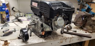

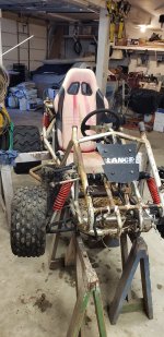

I was really hoping someone here would know where to get a clutch or parts for this cart. Anyone have a parts list/catalog for this? Ever take one apart?

For those size tires on a heavy off road kart, you need a torque converter not a centrifugal clutch.
The original motor had internal gear reduction , so that's why the rear sprocket is so small.
Even with a torque converter, the gear ratio will not be adequate for the 212cc. No bolt on, off the shelf sprocket will fix this.
So your looking at buying a torque converter, and adapting a 60t minimal or preferably larger #40 sprocket to fit the axle,
Or making a jackshaft to compound the gear ratios with a #40 input sprocket, and # 50 output to fit your current rear sprocket.
Parts are all over the internet, but I suspect this is a bit more of a project that you anticipated.
panchothedog
1,426
1,947
Do you know the diameter of your axle. There are tons of parts available for a
1" axle . You will never find anything for a # 50 sprocket or chain. As mentioned
by Karl you need a torque converter, not a centrifugal clutch. If your axle is not
a 1" piece it is going to be hard to find a hub, or carrier onto which to mount the # 420 series X 60 tooth sprocket you need to buy. If that is the case it might
be easier and maybe even cheaper to buy a complete 1" rear axle assembly or
kit . Either way you are looking at at least $120 to $200 in parts.

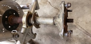

I will soak the end of my axle in a diesel ATF mix then try again to get it apart. Karl, you are correct, it is turning into more than expected. One of my problems is during the rust clean up and repainting project I need to keep reminding myself this is not a 65 Mustang and good is good enough...

hard on gas, 100% of the time. On torque converters I am going to disagree with Denny just a tiny bit, a 30 series will hold up. Plus you have no choice.
Your engine has a 3/4" output shaft and that is the most robust one available.
All of my karts ( 4 ) are big two seater 's like yours, running 18" to 20" tires .
3 of the 4 have 212cc or 196cc engines and use the 30 series torque converters with no issues. How tall are your rear tires? When you buy the converter it will come with a 10 tooth sprocket. Mated to a 60 tooth sprocket on the axle is IDEAL gearing most all situations. If your tires are taller ( 22 ) or you want more power and less top speed, it is much easier and cheaper to change the drive sprocket to a 9 tooth or even 8 tooth and leave the axle sprocket alone.

Also to get that axle apart you will need to sand it clean and use a hydraulic press to get it apart. Heat and beat will not work on that axle.
