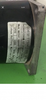

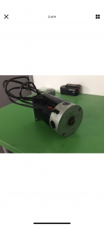

So I’ve located this motor, my only query is (excuse the ignorance still new to motors etc) the shaft looks rather short?

It looks like that motor was designed to "mate" up with another component. (transmission, pump etc.)
I don't see how you could add a drive sprocket to it, without building a "sprocket tower" (with a bearing) to support a sprocket.
Also, do you have a 36V 1,200W speed controller to control that motor?

That motor is missing the gear reduction piece that bolts to the face where the shaft is. It is supposed to have a 13:1 speed reduction to the output. I would get a different motor.
