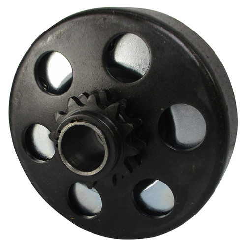

Would this be the right clutch? 12 tooth for a #35 chain? I don't know the chain # / rear gear tooth count on the c200u / gear ratio. Thanks in advance.

Clutch sprocket# must match axle sprocket#. Everything I see on the Coleman 200 calls for a #420 chain, so #420 sprockets. The #35 chain above only works with #35 sprockets.
#420 is a stronger 1/2" chain, #35 is 3/8" chain. Others here can tell you if #40, #41, #420 are all compatible or not. You just need to know for certain what # that axle sprocket and the chain is, get clutch to match. Call OMB or others with questions.
