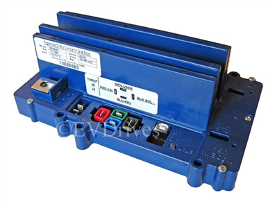

OP would be able to limit the draw from battery with the speed controller wouldn't he??
I guess it depends on which speed controller is used??
Yup, a user can set the current limits on the higher end speed controllers
...but, with most of the simple/el-cheap-o controllers the only way to limit the current would be to "go easy" on the throttle
...&/or maybe incorporate some kind of a "throttle limiter" (AKA a block(er) under the throttle pedal)
