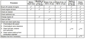

What is a "life" of a stage 3 212, living in typical bike or kart?
2hrs ride time 7 days a week is like 750 hours a year.
So let's say average of 20 mph for 2 hrs, that is a ton of probably unrealistic numbers @ 15,000 miles.
I know growing up we beat on them at least a couple hours aday and they lived for several years(stock engines)
So when to change oil? Every 40hrs? :popcorn:
Disclaimer...my math is my math....🤪

No offense meant, it was actually a real question, not messing with you or anyone else.
Seriously what is life span, oil change on these things?
Used to change log splitters every spring after condensation settled down to get water out, kinda like 2 stroke boat engines, in the late fall both got cylinders dusted with spray oil to lube rings and cylinders.
Having $500+ invested in a toy engine is a thing.

Never been a set number of hours or of time in my head for it, just been kind of a feeling about it. Like the higher it revs, the sooner it gets the oil changed. If it's been under-powered so hence full throttle at all times, it gets changed sooner. Kinda hard to explain what it feels like.
Well for a bone stock engine it's recommended at 20hr intervals.
Typically the lifespan of a new , stock and governed predator is around 500-1,000 hours.
Double that for a genuine honda.
One the governor goes, that is shortened quite a bit.
As far as staged engines, that is going to heavily depend on the build, maintenance, and usage.
Running around a track wide open for a whole race is going to be much more intensive on an engine
than putting around and occasionally winding it out.
So instead of changing the oil every race or hour runtime give or take, you can probably get
away with every 3-5 hours or so.
The race engine may only last 30-60 hours , you can expect more, 2-300 tops?
I run most my 212's at full go most the time, so shorter life and drain intervals.
Like the professor say's, it will take some judgment on your end.

Yeah, I figured a lot of guessing.
Reality for me will be 5 min ride to boat and back home a couple times a week. And a couple times a month 3 mile round trip for ice cream 🍦😋 at closest marina.
Not really, just check the oil occasionally and use common sense.
I gave an interval , but unless you have an hour meter, your guessing too.
Neither does 99% of predator owners, so I doubt the 20hr change is strictly followed.
