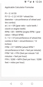

What do you mean by "forget what these guys said"? I'm the only one that was posting on his feed and I literally gave him the info from a quick Google search. He said he was running out of time so I kept it simple. He said he was looking for more torque vs top speed and what I told him will definitely accomplish that. Oh and the link for the calculator at gokartsupply doesn't work properly so I used the one at BMI KARTS. They spec theirs for a "safe junior kart" so people aren't killing themselves. As far as the gear ratio though, it's saying the same thing I said.
