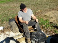

The exhaust valve is sticking, so it looks like the SV600 thumper will go back to the dump or ride a shelf for a while if I have room somewhere.
The Courage 25 looks right at home in my T bucket pile. This is mostly tractor parts and some scraps just to see what a bucket kart would be like.
Will try to see if I can get the twin to run next.
I think the wiring diagram shows a spark advance module, but I did not see any "control" looking electronics left in the Cub when I pulled the motor.
Do I need to use any external electronics to run it?
