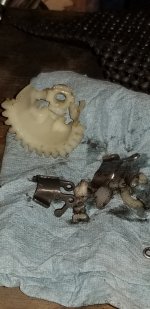

Yes, when you do a governor delete you have to break the engine open and remove the inside parts!!!!! These shattered parts got into my compression release and made starting our engine extremely difficult.

888
Governor warning to all: Delete EVERYTHING if you disconnect that external arm. I left the rod that twists that arm just sticking up out of the block with the cotter key on it for safety. Key vibrated off, that "L-shaped" rod (turns 90 degrees inside of block) dropped down, the crankshaft counterweight hit it, bent it and jammed it against the block. All because I didn't want to split the case. When you do split it to remove the governor parts, DON'T FIGHT with needle-nose and screwdrivers and whatever to get that nylon gear and the 3 washers out of there. Just pop the flywheel off the other side to expose the pin that the gear spins on, and punch it into the block. Be sure to get all the parts out of the block, and drive a 1/4-20 bolt into the hole to seal it. If hard to get that "L-shaped" arm out, just pull the crankshaft toward you a smidge and let it fall out. Drive another of those bolts into that hole.

The same thing happened in my first engine and govenor pieces/parts got into my compression release causing other problems.
With my newest engine's full govenor delete, I didn't go though the extra work of removing the flywheel and didnt have much trouble removing the plastic gear and other govenor parts from inside the engine.
