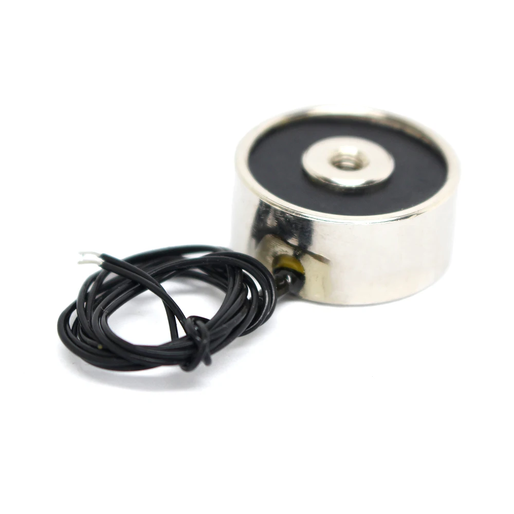

Hi Guys
Thanks for the information. I'm thinking something like a small electromagnet like this.
Placed in between the throttle linkage rod and the throttle cable.
So as seen here.
Item 106 would have the electromagnet attached to the end and item 38 would have a metal slug attached to it. Since the magnet will be on a rod I'll get a tube for it to slide in when the throttle is pressed and when the magnet is released the metal slug on the throttle cable will be pulled back by the spring on the motor. I agree yelling stop should work but in my experience with kids on powerwheels it doesn't always work. They seem to freeze up and forget I can just take my foot off the gas.

The only problem I see with that is the throttle cable I think will need its own return spring as the pedal won't be doing the returning for you and honestly I don't trust the one on the engine.
Also, due note that in the case of any malfunction, your kid will lose ALL throttle. Depending on the situation it could be potentially dangerous.

Hi mckutzy
I agree that would do the job but honestly I have a 27Mhz Transmitter and receiver from my old RC car that has a range of 1/4 mile. I don't likely need that kind of range but I can see needing more than 250'
As far as loss of throttle since I'll be using a 3 channel radio and receiver I can still have a kill switch operated by servo.
I will need to modify where the brake pedal spring is located but that should be easy.
I just thought someone would have a ready made product that didn't totally kill the kart but you still could if need be. It sounds like it doesn't exist at this time.

Yea it would be great if I could power or at least charge the unit off the motor but the electromagnet is failsafe by design since it requires power to keep the magnet attached to the slug pulling the throttle cable. The receiver and servo I'll need to watch, but the stock power supply was 4AA batteries. I'm using 2 18650 lipo so I'm thinking it will last as long or longer than the original batteries did and they would last quite a while and they were powering 3 servos.

What about a remote actuator flap in the airbox? It wouldn't be instant response, but it may also not totally shut the engine down either.

Electric linear motor that returns throttle back to idle when switched on remotely.

I like the ideas but I'd need to see the implementation cause I'm having trouble picturing it.
A few things I'm discovering during the development of this is,
1. It's hopefully a short temporary need.
2. Because it's temporary I don't want to make it too difficult to
remove.
3. It's best if it can be quickly bypassed for when I'm driving so I don't
have to turn anything on and use the batteries.
The solution I'm using for problem 3 is I've run a 2nd throttle cable that I keep disconnected when I'm not driving. Since the Predator engine has at least 2 throttle cable mounting options I keep both connected to the engine and just connect the bypass cable up to the throttle linkage rod when needed.
Thanks again for all the ideas and tips.
