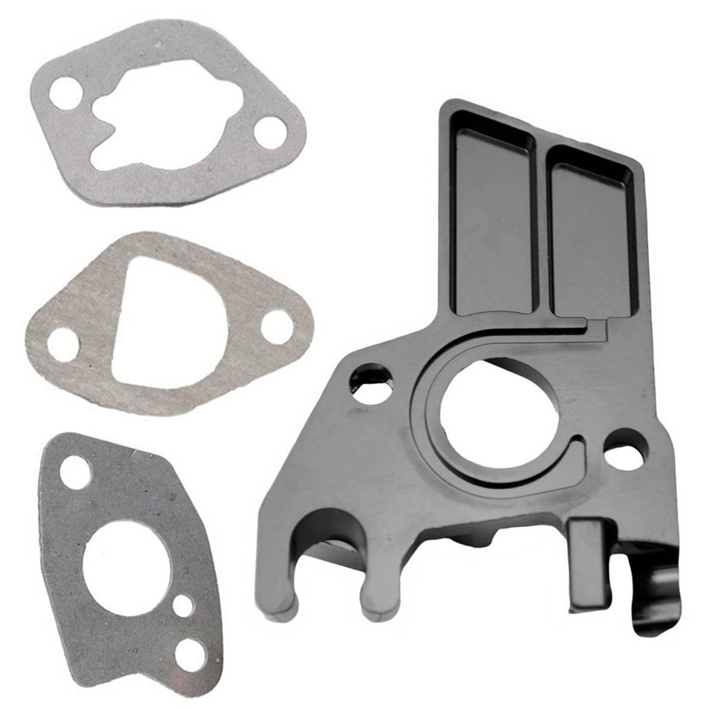

So I then took the newest carb off and something struck me. The new carbs came with 3 gaskets. One of them seemed to fit the holes etc but there is a groove on the engine side and also on the carb that appear to be a passage for air. The gasket has two holes for the mounting studs and another one that does not match up perfectly with anything. The additional small hole in the gasket does partly allow the groove to show on the base of the carb.
I also put a paper filter with adapter on the carb. The gasket where the adapter to the carb meet "could" possibly cover one of the small holes that seem to need air flow into them. I will check and make sure these holes are not blocked by a gasket.

Here is the layout of the gaskets....
Also inspect the phenolic insulator plate for cracks... it gets damaged sometimes apon re-tightening..
The gasket that mates with the airbox housing has the side notches on it...
Shown in the top of the pic...
If one were really careful, and the carb was free of gasoline and o-rings on the bottom of the carb.... You could apply a small amount heat to the end of the pickup where the jet is. That should help to free it up to unscrew....

Thanks again. I was not sure how this "black" phenolic insulator mounted etc. Good info and another possibility of a vacuum leak.
I have used a small amount of gasket maker on the gasket between the carb and the phenolic insulator. Started the engine with choke closed and the throttle partly open. It starts well and then idles down when I turn choke off or open. I can run up the rpm's to about half speed and it seems to run better. However, if I run the engine a couple minutes and at faster rpm, it just dies. I really believe my float bowls on the two carbs are not filling fast enough to operate under higher loads and rpm. This will be my next point of check along with the phenolic insulator. My fuel hose may have a kink in it under the tank.
