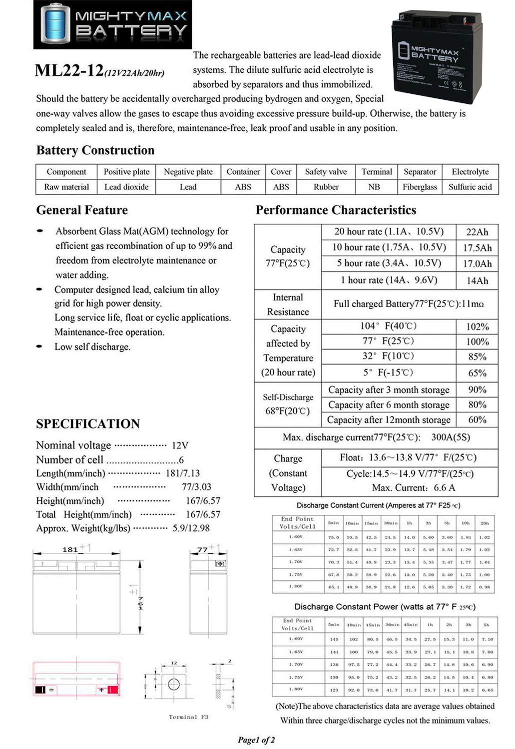

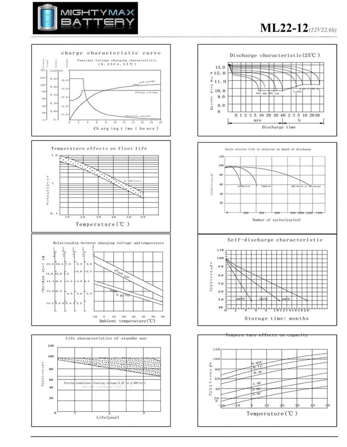

These are smaller SLAs and I'm not seeing a CCA like an automotive battery would have. The capacity is just listed in amp hours (22Ah) and a max discharge rate of "300A (5S)" - 5S meaning 5 second duration? At any rate, is seems like 60A should be well within the capabilities of this battery (not expecting it to last an hour at that rate of course), and I'm guessing that a 1.2-1.7V droop under that load is within spec maybe.
Battery Data Sheets:
Datasheet1
Datasheet2
So, just for clarification, what I'm seeing with both of my controllers is a draw of about 60 Amps at peak demand, so I'm thinking maybe that 1800W rating on each controller is an electrical rating. I don't remember what it pulled with just one motor attached but the controller does have a documented 32A limit.
So, it sounds like maybe, with my peak draw of 60A, ideally I would want 60Ah. 22Ah being too lean. 44Ah still being lean, but better - and droop would be less. 66Ah would be ideal with a little wiggle room.
For what it's worth, I've been running the kart through the paces, and pushing it pretty hard. Everything stays VERY cool, including the batteries. I only feel the slightest hint of warmth from the controller and everything just feels very cool.

The good news is the second datasheet..
it tells us that the manufacturer emptied the tested battery at a 60A rate
(8 minutes second diagram leftmost curve)
which to me suggests it's safe to do so.
(actually pretty impressing considering it's a small AGM battery)
Bad news is.. at that rate it can only deliver roughly 9Ah (a bit less.. but AGM.. so yeah)
it'll recover slightly I guess so you might be able to get another minute or two
of limping back home after you allowed them to rest for a good while.
NOT a good idea to do that repeatedly IMHO,
but the battery shouldn't overheat and burst into flames if I can trust that datasheet.
