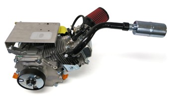

I'm building a Worksman Adaptable tricycle into a motorized trike using a 212cc Predator 6.5hp engine
I have a very thorough knowledge of bicycles, but pretty much haven't got a clue about engines apart from the basic mechanics of how they function. I'm getting a Predator from Harbor Freight, running it with a torque converter, and purchasing all the other gasbike.net trike kit parts from ebay/amazon. I'm gonna use this trike to commute to/from work, I'm aware it's not street legal. Planning to cruise at ~15-20mph in the bike lane with lights/reflectors and follow traffic laws to appease cops.
I'm posting here because I need some advice, I was wondering what a good sprocket size would be to pair with a 10T driver?
Tricycle weight with rider, engine, and gear will be about 330lbs. The 212cc 6.5hp engine is rated at 3800rpm, 8.1 ft-lbs@2500rpm, I'll be using a torque converter. I'd like to be able to cruise at 20-25mph and care more about less engine strain and durability rather than top speed. Choices I see with the kits seem to be 36, 40, 44, 48 mainly?
Also, I want the engine to run as quietly as possible since I'll be in traffic. I was wondering if it's safe, in terms of backpressure and stuff, for me to only install an aftermarket exhaust pipe and muffler. Down the line, I do plan to also get an air filter, springs, and re-jet kit to improve performance, but I was wondering if it's safe to wait on those and for now just run the engine as is, but with an aftermarket torque converter and exhaust & muffler to quiet things down.
Thanks so much!

That all sounds like a good plan. Of course you can leave it all stock.
I have seen a couple goofy configurations of a Car muffler attached to a small engine.
Not that it is a goofy idea, it will definitely keep it quiet and wont hinder performance.
Just what Ihave seen were hack jobs.
Sorry I am not aware of the proper gearing for this project. But I like the idea. Best of luck.

Would it be ok to run an aftermarket exhaust & muffler without messing with the internals of the engine? Thinking something like this for $50
  #11
Old 09-23-2016, 10:37 PM
chancer's Avatar
chancer chancer is offline
ɔ ɥ ɐ u ɔ ǝ ɹ
Join Date: Oct 2013
Location: COMFORT, TEXAS
Posts: 9,363
Thanks: 2,439
Thanked 3,071 Times in 2,394 Posts
Default
Yes

That's why I said that earlier, and like wise, I think also thats why my bike is fine in the ratio dept, cause of little contact patch to the ground comparatively speaking to other similar bikes...
Also, the theory is for when it is at a standstill to get it moving...
OP- The header and filter are a cheap basic upgrade, kits are out there, also you will most likely need to re jet the carb...
If any of those kits have new springs, dont bother using them unless your going to open the motor and do more than above.

And If you get a kit from GoPowerSports.com it comes with a proper jet for the new filter.
and use coupon code DIYGOKARTS for 10% off

Quote:
Are you saying that if I install only an exhaust header and muffler (no air filter,l or springs), i would need to re-jet the carb?

Yes. The extra air that the intake allows need a little more fuel. Not to worry though it is easy!
