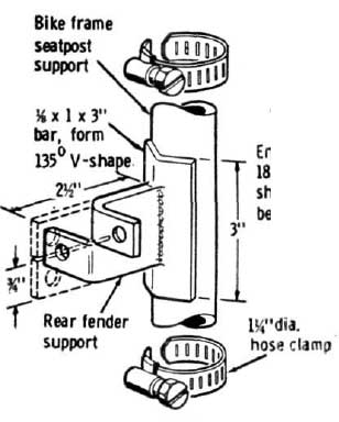

You can find chromed fenders from parts suppliers, and you may mount them in an adjustable way shown in fig. 4 and fig. 1.
